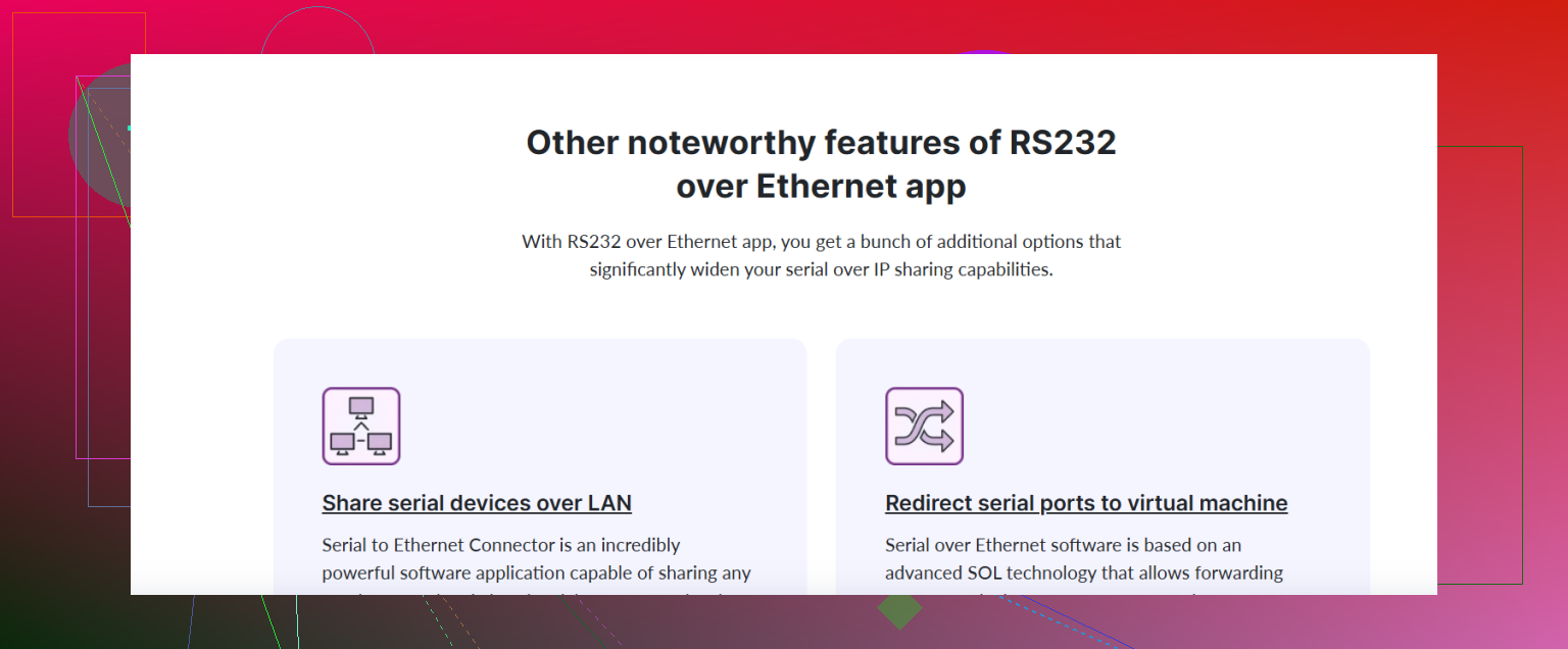

Don’t buy a serial device server before testing recovery with your actual application. For your setup, I’d start with software: share the physical port on the device’s computer and create a virtual COM port on the application’s computer. I’d try Serial to Ethernet Connector as the COM redirector app, though its license cost would give me pause for a single device. It supports virtual ports and reconnection settings. (serial-over-ethernet.com) The deciding test for me would be briefly disconnecting the network during use, then checking whether the application resumes or needs its port closed and reopened. Repeat after rebooting the host, without logging in. I’d consider dedicated hardware if keeping that computer awake and available becomes a nuisance, but I wouldn’t buy it on the assumption that it fixes application-level recovery.

Buying a serial device server doesn’t automatically mean a driver-free setup. If your application only accepts COM ports, check that the server provides a redirector compatible with your application PC’s operating system. Hardware replaces the computer at the device end, not necessarily the software at both ends. I agree with starting in software when that computer is staying anyway. I’d use Serial to Ethernet Connector, with this app handling the connection. I’d choose a dedicated server if the goal is to remove the device-side computer entirely.

A device that just streams readings behaves nothing like one where your app flips DTR to reset it, and that split decides everything before you touch software or hardware. @bluemaker already nailed that, so I’ll just say it loudly: confirm the RFC 2217 handling first, and if you do go the software route, Serial to Ethernet Connector handling multiple client connections to the same port is handy when a config tool and your app both want a look.
RFC 2217 on a spec sheet and RFC 2217 that actually forwards DTR when your app flips it are two different things, so test the toggle instead of trusting the checkbox. @cloud_lynx is right that the busy command sequence is where it falls apart, but I’d stop treating latency as a hardware-versus-software question. A box doesn’t shave off round trips either way. The thing nobody’s pinned down yet is reboot behavior with no one logged in. If the port doesn’t come back on its own after the host restarts, you get a silent dead connection and a confused user. Serial to Ethernet Connector runs as a background service for exactly that, which is the part I’d actually lean on. Everything else comes down to whether your app can sit through the delay.
